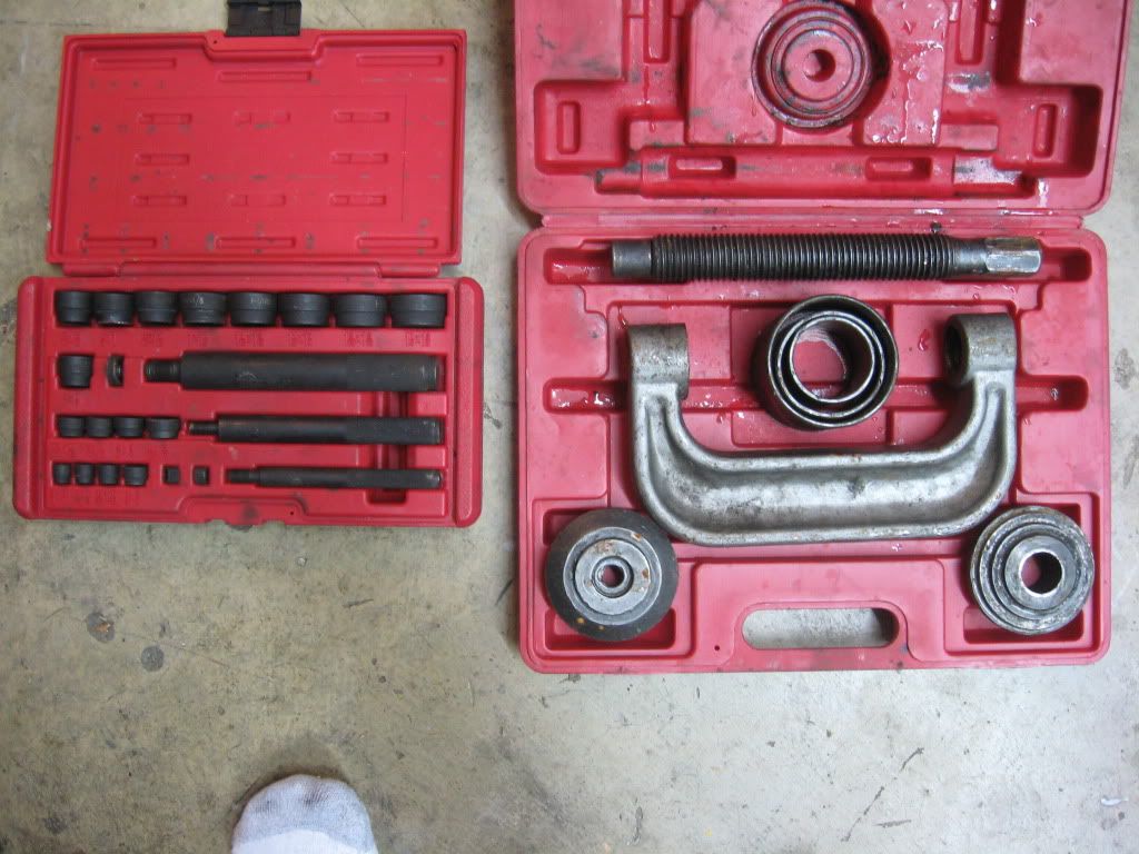

Message were very handy. The bushing driver set was used to drive the outer metal sleeves out of the arms after a slit was cut through them(I used a hole saw to first remove the inner sleeve).
The ball joint press was used per sawbonez writeup in the faq section. I was able to use it to remove the ball joint as well as install the new one's however.
